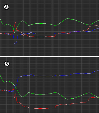

Compensates for gimbal locking effects by unrolling rotations. Unroll Rotations is designed to clean motion capture data that contains large rotations which cause flipping or shaking in animations.
Unroll rotations filter A. Original curves B. Unroll Rotations applied
