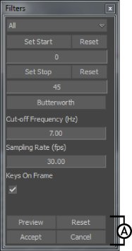

Preview, Reset, Accept, and Cancel buttons
When you select any filter, the Preview, Reset, Accept, and Cancel buttons appear at the bottom of the Filters window. Use these buttons after defining the filtering area, selecting the filter, and, if necessary, selecting the properties to filter.
Filters window A. The Preview, Reset, Accept, and Cancel buttons
ButtonFunction
PreviewLets you see the effects of a filter before you accept the filter.
ResetReturns the animation to its original state without changing the Filter settings.
AcceptLets you apply the filter to the animation.
CancelAborts the filtering operation without changing anything.
