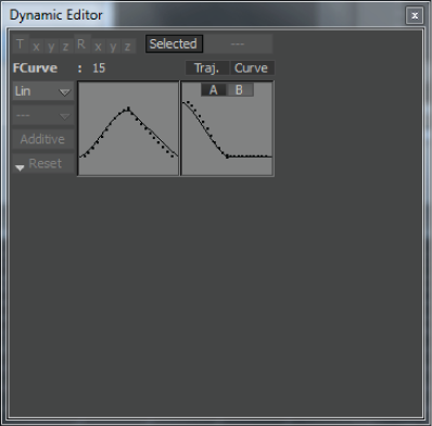

To edit Linear interpolation:
  1. Move the Timeline indicator to the animation you want to edit or select a range of keyframes.
  2. In the Dynamic Editor, select Linear in the Interpolation Mode menu.
    The selected animation has Linear interpolation. See Linear interpolation for more information.
    Dynamic Editor A. Linear selected in the Interpolation Mode menu
