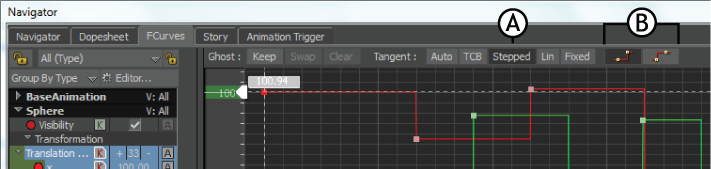

To change the interpolation of a keyframe to Stepped:
  1. In the FCurves window, select the keyframe or keyframes whose interpolation you want to change.
  2. In the Tangent options, select the Stepped interpolation type.
    FCurves window (detail) in Classic Mode A. Stepped interpolation type selected for the keyframe selection B. Step and Step Next mode
  3. Select Step mode or Step Next mode, which determine whether the interpolation maintains the value of the current or next keyframe. See Stepped interpolation for more information.
