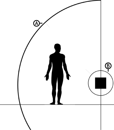

    A. External Range limit B. Internal Range limit
    The magnetic field is very strong; it is approximately 1.5 feet around all emitters. If the calibration pole or a wired performer stands within this area (Internal Range Limit), it is impossible for the position of the magnetic sensors to be accurately captured.
    The magnetic field from the emitter also has a physical range (External Range Limit). If the calibration pole or a wired performer gets too close to the limit or moves outside the range, the position of the sensors cannot be properly captured.

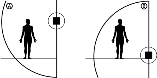

    It is important to place the emitter at the proper height. A magnetic field is circular, with its longest range near its horizontal or vertical middle. For best results, place the emitter at a height where the longest part of the magnetic field rests over the capture area. Problems may occur during motion capture if an emitter is too high or too low .
    A. Emitter is too high. The performer’s feet may not be captured. B. Emitter is too low. The performer’s hands may not be captured if they are raised over the head. Even more may be lost if the performer jumps.

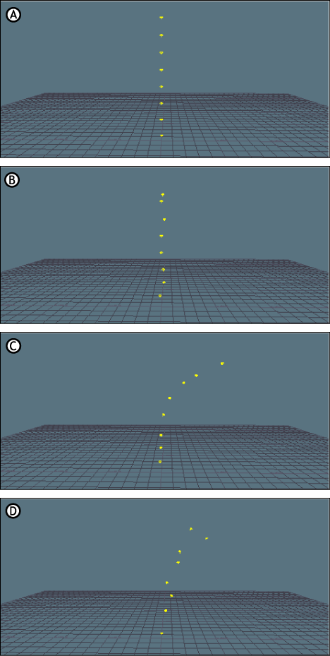

    To test the area, MotionBuilder must be running and the appropriate magnetic device must be added and set up. Then move the pole around the edge of the proposed capture area and around arbitrary locations within the capture area. While you move the pole, watch the Viewer window to see how sensors react to your proposed capture area.
    For example, in the following figure, A represents an ideal capture, because the sensors are straight, and are exactly as they appear on the pole. In the same figure, B shows that the sensors are not completely straight, but would be easy to calibrate. In the same figure, C shows that the sensors are limited for a capture but they can still be calibrated. However, in the same figure, D shows too much distortion produced by sensor 8 (second from top) relative to sensor 7 (top sensor).
    A. Ideal capture B. Suitable capture C. Limited capture D. Poor capture
