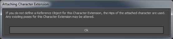

  4. Click OK in the Attaching Character Extension dialog box that appears.
    This dialog box appears to remind you to define a Reference object for your Character Extension. It is important to define a Reference object as you attach the Character Extension because all poses and transformation for the Extension will be based on this object.
