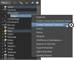

In the Scene browser, right-click a characterized character and select Create Character Extension.
Scene browser A. Create Character Extension option

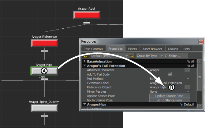

Create a Reference Object for this Character Extension by doing the following:
Select the closest part of the body that affects the movement of your Character Extension. Normally, this is the direct parent of the Extension, but it can be any object associated with the Extension.
For example, if you are adding a tail, you might select the Hips bone, because you want the tail to be attached at the hips.
Alt-drag the selected body part into the Character Extension’s Reference Object field in the Properties window.
A. Selected bone to be associated with the Character Extension B. Reference Object property
This creates a Reference for your Character Extension, which is used to calculate all future positioning of the Extension, for example if the Character Extension is included in a pose.In the Properties window, view the list of properties to be keyed when you set a keyframe on this Character Extension. Add or remove the properties you want to have keyed by right-clicking and selecting Remove Property from Extension or Add Property to Extension. These properties are also included in any poses you create for this character.
