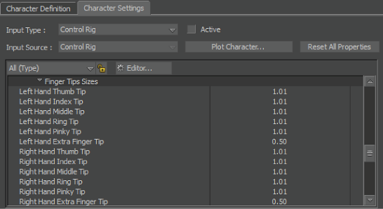

Finger Tips Sizes
Adjust the size of each of the floor markers used to outline the finger tips for both the left and right hands.
Finger Tips Sizes group of properties
