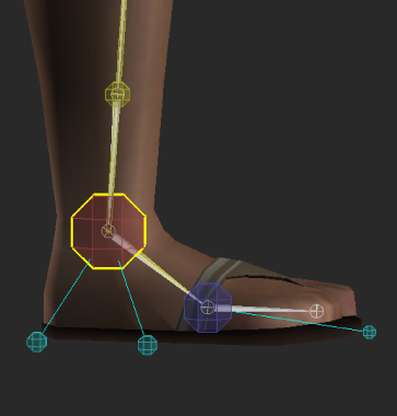

By creating multiple Auxiliary pivots for an IK effector in the foot of a character, for example, the feet can rotate around multiple independent pivot points in order to create natural-looking walk cycles.

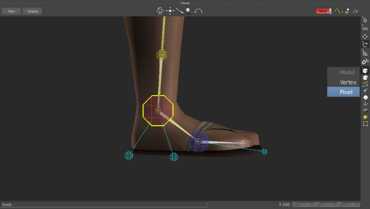

Three Auxiliary pivots display for two IK effectors in a character’s foot
As you set keyframes, you can switch between Auxiliary pivots, making the foot rotate around the ankle, the heel, the base of the toes, the tip of the toes, and even the sides of the foot. For more information on switching between pivots, see Setting a master Auxiliary pivot.

To manipulate Auxiliary pivots, select Pivot mode from the Selection Mode menu in the Viewer window. Pivot mode is automatically selected when you create a new Auxiliary pivot. You can then select and define offsets for the pivots by dragging them to new positions relative to the IK effector.
When you are in Pivot mode, transforming the pivot affects only the Auxiliary pivot itself. To use the pivots to manipulate an effector, switch to Model mode. For more information on the Selection Mode menu, see Viewer window.
Viewer window A. Select Pivot from the Object Mode menu
