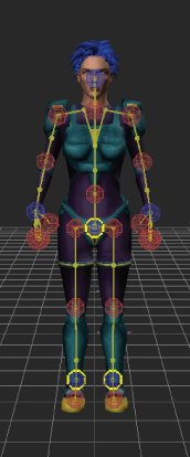

There are various ways you can change the look of Control rigs. For example, you can change the shape and color of effectors, scale selected effectors, or change the color properties of selected nodes or bones.
Switch to X-Ray mode in the Viewer window (Ctrl+A) before making adjustments to your rig.
Select the effectors in the Character using the Character representation in the Character Controls window, the Viewer window, or Schematic view.
From the Resources window > Properties tab > Select Property View drop-down list, select All (Type).

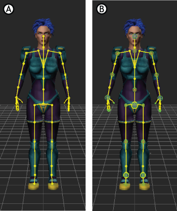

From the Marker Settings > Look drop-down list select None.
Control rig effectors A. None option selectedB. Sphere option selected
Turn on or off all IK or FK effectors on a Control rig from
> Show/Hide menu. (For a clearer view, you can also deactivate options to isolate your selection on the rig.)
Change the size of the effectors using the Marker Settings > Size field.
IK effectors set to 400.00
You can also change the shape, color, and transparency of markers using the settings in the Marker Settings section.
