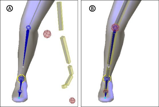

A character’s leg between keyframes A. Align Control Rig is disabled. B. Align Control rig is active.
Displaying the two systems forced together gives you a more intuitive way to manipulate the rig, as it replicates direct manipulation of the bones of the character. The IK and FK elements can still be manipulated individually, are solved differently, and have different function curves, but you can manipulate them and their children while previewing the final solving.

The way the FK and IK systems are solved remains the same when the Align Control rig option is activated. The difference is that the two systems are synchronized visually in the Viewer window and you can clearly see the final solving that affects all child objects.
