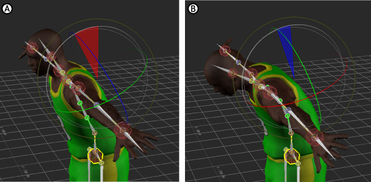

In the following figure, you can see the difference between rotating a series of spine bones in Global Reference mode and in Local Reference mode.
Rotating FK effectors in the spine. A. Using Global Reference mode. B. Using Local Reference mode.
