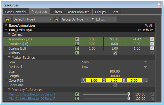

For example, if you select the FK effector for the hips and view its properties, property references to the IK Blend T and IK Blend R properties for the IK hips effector are also listed.
Properties of an FK effector for the hips. A. Two reference properties for the IK effectors of the hips are also listed
These reference properties let you hide the IK effectors, work only with bone-like FK effectors, and still view the Reach feedback for your Control rig.

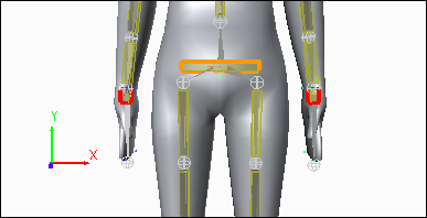

FK effectors on the hips and wrists display Reach Outline visual feedback for hidden IK effectors
