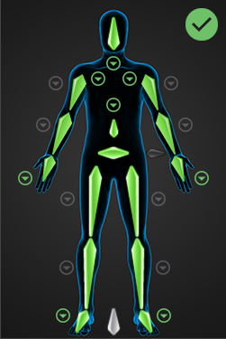

  1. Do one of the following to start mapping bones to the Character:
    • Go from the Definition tab to your skeleton: Double-click a cell in the Character view (cells turn blue when picked), then click the corresponding bone in the scene.
    • Go from your skeleton to the Definition tab: Select a bone then right-click the corresponding cell in the Character and select Assign Selected Bone.
      Bones in the Character view turn green to indicate each valid bone assignment.
    For more information on which bones map to which nodes, see HIK character structure.
    Tip:
    If you have used a standard left or right naming convention and keep the Mirror Matching option on, and map (for example) a right leg bone, the tool automatically maps the left bone for you. See also Edit menu and Activate and configure mirror matching.
  2. Continue mapping until you have all required bones defined. Once you have mapped all required bones, the validation status indicator turns green, and you can lock the character definition.
