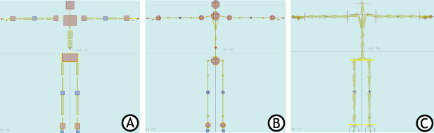

> Edit > Controls > Rig Look, then select the effector type you want:
Rig Look A. Box B. Stick C. Wire
