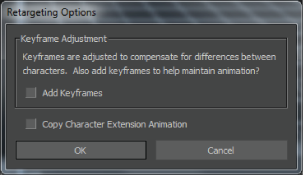

, select Edit > Controls > Retarget Rig.
In the Retargeting Options dialog box that appears, activate or disable any options you choose.
For example, activate the Add Keyframes option if you are concerned with retargeting your original animation as precisely as possible. See Retarget option in the in the File menu > Load Character Animation Options dialog box. for more detailed information.

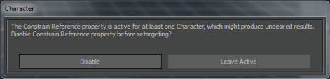

If the Constrain References property for one of the characters is active, a Character dialog box appears asking if you want to disable the Constrain References property. Click Disable if you want to turn off the active Constrain References property. See Constrain References for more information on this property.
