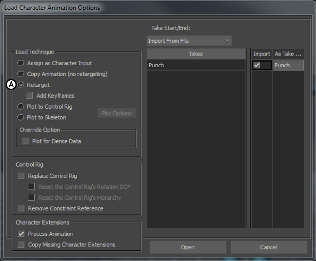

The Load Character Animation Options dialog box appears.
Load Character Animation Options dialog box A. Retarget option
In the Load Technique area, select the Retarget option.
Select Add Keyframes if you want to allow extra keyframes to be added during retargeting. Keyframes are adjusted when necessary during retargeting to compensate for differences between the two characters. Allowing added keyframes helps to preserve the original animation as closely as possible.
Make sure the take you want to retarget is selected in the Take list.
Click Open.
