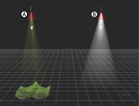

Projecting light on the ground
To display the projected gobo image:
  1. Select the Spot light in either the Scene browser or the Viewer window.
  2. Activate the Draw Ground Projection option in the Light settings to show the light projected on the ground.
    Draw Ground Projection A. Activated B. Disabled
