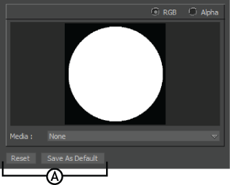

Select the light in the Scene browser of the Viewer window.
Set up the light so that it has the settings you want all future lights to use as a default.
Click Save as Default in the Light Settings.
This retains your current custom light values as a new default setting so that any new light have these values as a preset.
Image Preview area A. Default light settings
