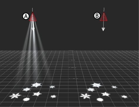

For example, the following figure shows two lights, one with Draw Volumetric Light activated and one with Draw Volumetric Light disabled. If you set Fog Intensity to 0, the Draw Volumetric Light settings have no effect.
Draw Volumetric Light A. Activated B. Disabled
