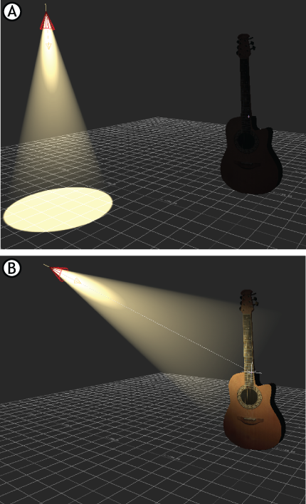

    Spot light interest A. Spot light with Interest not set. B. Spot light with Interest set on the guitar.
Click the Interest field to select the element you selected to be the light’s interest, and both the light and interest object are selected. When the light is translated, the light’s interest follows it.
