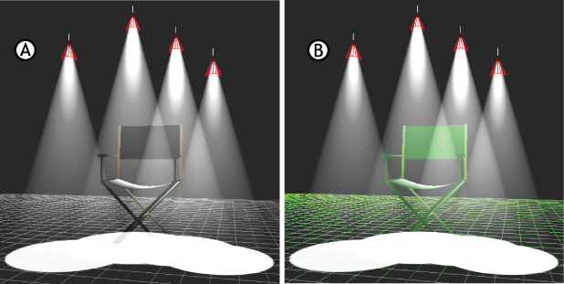

    A. Fog settings disabled B. Fog settings activated and fog color set to green.
