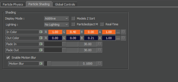

The Particle Shading pane in the Shader settings lets you customize the visual appearance of the particles used in the Particle shader, such as lighting, color and motion blur.

Use the Display mode menu to set the way particles are shown in the Viewer window.
| Display mode | Effect |
| Additive | Displays particles in additive transparency mode. |
| Matte | Displays particles in the opaque matte mode. |
| Translucent | Displays particles in translucent mode. |

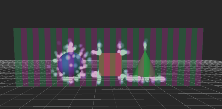

Activate Models Z Sort when you want to show particles behind other transparent models. Models Z Sort redraws the particles so that they appear behind transparent or translucent objects when in Additive or Translucent Display mode.
The Models Z Sort option sorts models by bounding volume and then draws each model from back to front.
Activate Models Z Sort to show particles behind transparent models.
For best results, the bounding volume of a model should not intersect other bounding volumes. Also, the Models Z Sort option works best with simple geometry and polygon culling, if your geometry is constructed with consistent polygon orientation (all polygons should be constructed either clockwise or counter-clockwise). Polygons with opposing orientation are clearly shown as artifacts when attempting transparency.
Polygon culling is specified for each model in the Shader manager. See Flat Shader transparency types for a description of transparencies you can use on your models.
When using Models Z Sort, activate this setting so that each particle is sorted individually, creating a more realistic particle effect.
Activate this option to view the sorting effects of the Models Z Sort and Particle Object M options in real time. If this option is disabled, the Models Z Sort and Particle Object M effects are only used when rendering.
Due to the complex particle solving that these three Z-Sorting options present, activating the Real Time option causes processing speed delays.
The Lighting menu lets you select a method to light the particles.
| Lighting method | Description |
| No Lighting | The Particles are not lit. This is the default setting. |
| Simple Lighting | Performs a rough calculation of lighting: 1 normal is used per particle. In this method, the normals always face the camera. |
| Smooth Lighting | Performs a more advanced calculation of lighting to create a smooth effect: 5 Normals are used per particle. In this method, Normals surround the particle to create a more realistic effect. |
Use the In Color settings to set the color applied to particles at the beginning (In point) of their life time.
Use the Out Color settings to set the color applied to particles at the end (Out point) of their life time.
Use the Fade In slider to set a percentage of the particle’s life time that is used to fade in the particle.
Use the Fade Out slider to set the percentage of the particle’s life time that is used to fade the particle out.
Activate the Enable Motion Blur option when you want the particles to have a blur applied to them to imply motion. The higher the value, the more particles deformed.
Use the Motion Blur slider to set the blur amount for the particle as it travels, creating a stretching effect. Values range from 0.00 to 1.00.
