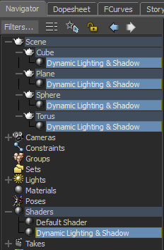

To use the Dynamic Lighting & Shadows shader in the scene objects:
  1. In the Asset Browser, navigate to the Templates > Shading Elements > Shaders folder.
  2. Drag the Dynamic Lighting & Shadow shader and drop it onto the object you want to receive shadows.
  3. From the contextual menu, select Replace All by Type.
  4. In the Navigator, select the newly created Dynamic Lighting & Shadow shader under your object.
    You can also copy the same shader to any other objects you want to receive shadows.
