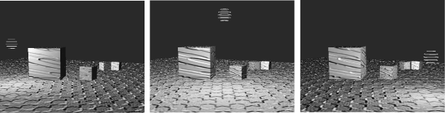

You can also use the Dynamic Lighting shader to read relief from Normal maps.
Use the Dynamic Lighting shader to create Normal map effects

In the Texture settings, select New Media in the Media menu then browse to select a Normal map texture.
The texture appears on the model in the Viewer.
