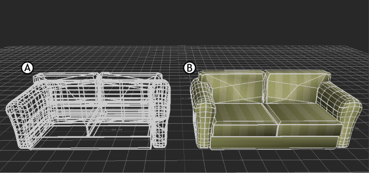

  3. Select Replace by Type from the context menu that appears to completely hide the object and display only the wireframe, or select Append to show the object with the wireframe outline.
    Wire Frame shader A. Replaced Default shader on sofa B. Appended to sofa
