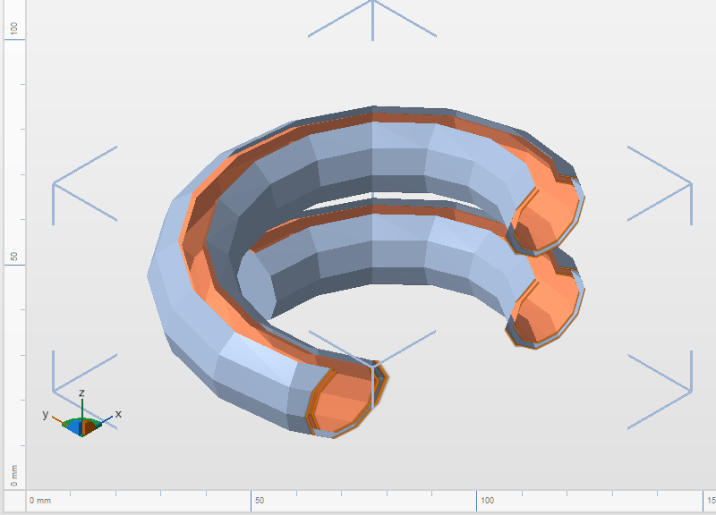

A hollow helix being edited (note the light blue color on the outside), and shown with its cross sections. It has had a number of surface triangles deleted.
