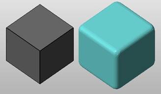

Inner offset (right) of a box
Outer offset (right) of a box
