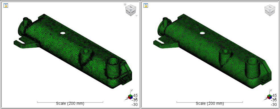

  2. When the Part Mapping dialog appears, locate the radiatortank.sdy file. Once selected, you will see a preview of the tank that you can use to verify the correct part was chosen. Click Continue.
  3. Locate the radiatortank.nas file. Click OK.
