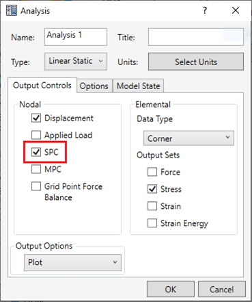

SPC (Single Point Constraint) refers to the Autodesk Nastran terminology of a constraint. Since
Autodesk Inventor Nastran is all geometry based, all the nodes on a surface with an applied constraint are considered Single Point Constraints.
This step is critical for extracting reaction forces due to enforced displacement loads.
