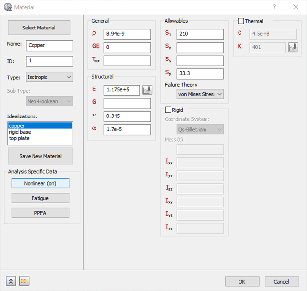

To define materials
- In the
Model tree, right-click
- In the
Material dialog, click
Select Material. The Material DB dialog will show some available material libraries.
- Expand the
Autodesk Material Library, select
Copper, and click
OK. This material will be chosen for the Billet.
- Click the
Nonlinear button, then in the
Nonlinear Material Data dialog select
Elasto-Plastic (Bi-Linear). Click
OK in this dialog and
OK to close the
Material dialog.
- In the Model tree, right-click
again.
- In the
Select Material, expand the
Alloy Steel, and in the
Material dialog, rename it to
Alloy Steel_Base Rigid.
- In the third column of the
Material dialog, select
Rigid. Doing this tells the analysis code to treat the bottom base plate part as a rigid body. The code will compute the center of mass and inertial properties of the part.
- In the lower left corner of the
Material dialog, click the Duplicate
button. The Alloy Steel_Rigid Base material is added to the model, and the Material dialog remains open for definition of a third material.
- Click
Autodesk Material Library, and again select
Alloy Steel.
- In the
Material dialog, rename the material to
Alloy Steel_Top Plate, and deselect the
Rigid option.
- Click
OK to close the dialog.

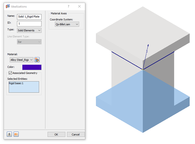

To define idealizations
- In the
Model tree, under
Idealizations, delete any existing Solid materials, then right-click
- In the
Idealizations dialog, set the following values:
- Name: Solid 1_Rigid Plate
- Type: Solid Elements
- Material: Alloy Steel_Base Rigid
- Select
Associated Geometry, then click the base of the model to apply this idealization.
- In the lower left of the
Idealizations dialog, click the New
button and set the following values for the Copper billet:
- Name: Solid 2_Copper Billet
- Material: Copper
- Select
Associated Geometry, then click the middle part of the model to apply this idealization.
- Again click the New
button and set the following values for the Top Plate:
- Name: Solid 3_Top Plate
- Material: Alloy Steel_Top Plate
- Select
Associated Geometry, then click the top part of the model to apply this idealization.
- Click
OK to close the
Idealizations dialog.

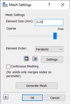

To mesh the model
- In the
Assembly tree, right-click
- In the Mesh Settings dialog, set
Element Size to
0.25 mm,
Element Order to
Parabolic, deselect
Continuous Meshing, then click
Generate Mesh to generate the mesh.
- Click
