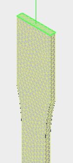

When enforced motion loads are applied as displacements,
Inventor Nastran requires that a constraint is applied in the direction of the displacement load. To create this constraint load:
Click
Constraints.
Select the top surface of the coupon with the applied displacement load (face <1>).
Make sure only the
Ty component check box is enabled.
