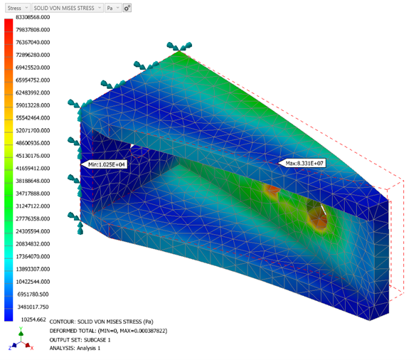

Finally, we can complete the rule by adding a command to create a contour plot after the solution is complete.
strCmdForDisplayContour = "<Contour ID=""1""/>" ' New Material i = AddinObj.Run(strCmdForNewMaterial) ' New Idealization i = AddinObj.Run(strCmdForNewIdealization) ' Mesh Model i = AddinObj.Run(strCmdForMeshModel) ' Generate Mesh i = AddinObj.Run(strCmdForMesh) ' Create Load i = AddinObj.Run(strCmdForLoad) ' Create Constraint i = AddinObj.Run(strCmdForConstraint) ' Run Analysis i = AddinObj.Run(strCmdForSolve) iLogicVb.UpdateWhenDone = True End Sub
Now we are ready to save the rule and run it.
