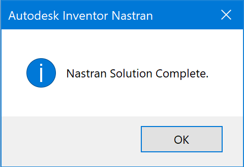

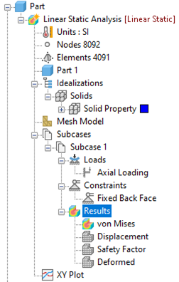

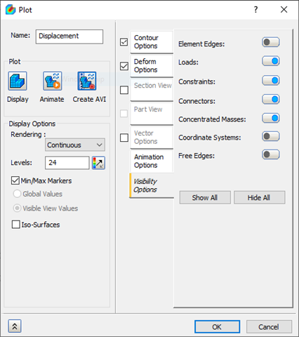

Results are automatically loaded into Autodesk Nastran In-CAD after the model is solved. After the solution is complete, Inventor Nastran places four different contour plots in the Results node under Subcase 1. These plots have default contour template settings, located at the bottom of the tree view, under Plot Templates.Each of these templates can be dragged and dropped into a subcase to create a new contour plot. You can right-click the template to edit the settings.
The tree view looks as shown below after the results are loaded:
