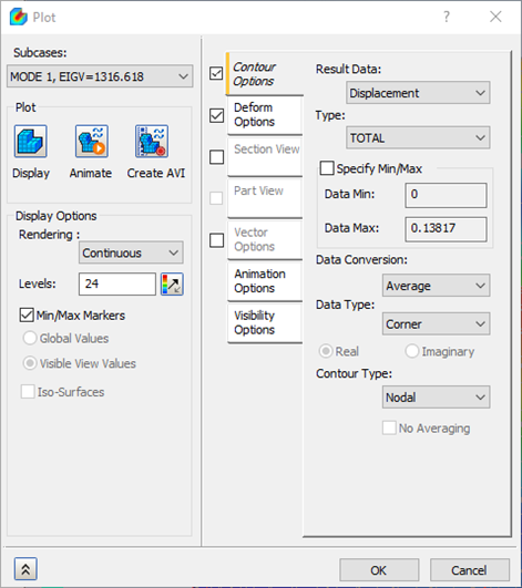

- Double-click on
Results and select
Mode 1 from the
Subcases list.
- In the
Result drop-down, select
Displacement, and in the
Type drop-down, select
TOTAL.
- Check
Deform Options and under
Plot, click

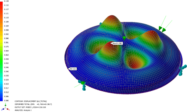

Display. The plot should look as shown below.
- The first and lowest eigenvalue is about 1316, which is of primary interest.
- When multiplied by the applied load, –1 Psi, you get the lowest critical buckling load of ~1316 Psi.
