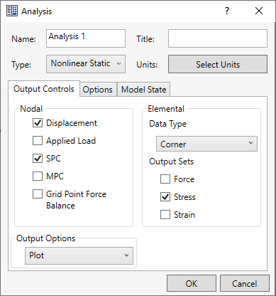

Right-click on
Analysis 1
and select
Edit
Change
Type
to
Nonlinear Static
On the
Options
tab, ensure that
On
is selected for
Large Displacements
Click
OK
