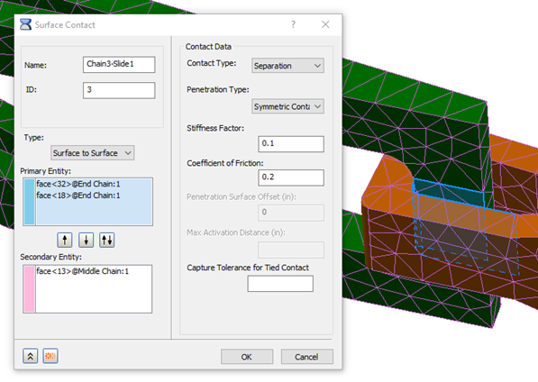

  6. Click the Duplicate button, delete all the Primary and Secondary Entities, and name the new contact Chain3-Side1. For Primary Entities, select two faces inside the front of End Chain, the flat left side, and the curved face in front of it. For the Secondary Entity, select the contacting flat face on the left side of Middle Chain.
  7. Press Duplicate, erase entities, and create a similar contact, Chain3-Side2, on the other side of the link between End Chain and Middle Chain. Repeat the process to create contacts for the link between Middle Chain and Lead Chain, Chain2-Side1, and Chain2-Side 2. In each case, there are two Primary Entities inside the back link, and one Secondary Entity on the outside of the front link.
