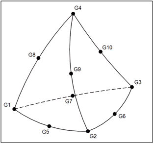

Elemental Geometry
Using the image of the linear solid tetrahedral element we can see that the origin of the element coordinate system is at G1. The element x-axis is defined by the vector G1 –G2. The element y-axis is orthogonal to the element x-axis and is in the G1-G2-G3 plane. The element z-axis is found using from the cross product of element x and element y.

There are two forms of solid tetrahedral elements currently available in this software: linear and parabolic. Linear elements have only 4 nodes. Parabolic solid tetrahedral elements have 10 nodes. Linear elements are stiffer and parabolic elements are more flexible.
