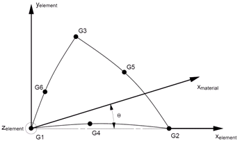

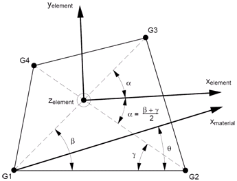

Elemental Geometry
The element x-direction is defined as shown in the images above for shell elements. Notice that when automeshed the G1 and G2 grid points (used to define the element x-direction) can be defined randomly throughout a mesh, hence the requirement to define a material x-direction to align the element output. Elemental z is defined from the node ordering. This can be either clockwise or counter-clockwise. G1-G2-G3 defines the element z-direction using the right-hand rule for the linear triangular shell. Element y is calculated from element z and element x.

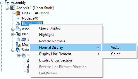

All shell element results are in the element coordinate system. It is important to note this because if a directional stress is desired, users must map the direction of the element x-direction using a material orientation. The default element x-direction is based on the node order of the shell elements. Because the auto mesher “connects the dots” in a consecutive fashion, the element x-directions can end up pointing in many different ways throughout a plane. Output for shells consists of a top and bottom value. This is useful because the top may be in compression while the bottom is in tension. Top and bottom is signified by the element z-axis. This vector can be viewed by right-clicking on Total Elements, then Normal Display and Vector or Color. Element normal vectors can be reversed.
Color Option – Yellow Defines the Top
Vector Option – Vectored Side Defines the Top
