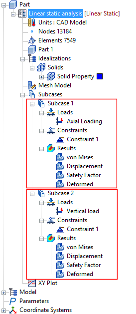

New Subcase
The New-Subcase option allows for multiple subcases to be added to an existing analysis.
An example is shown in the following figure:
There are two subcases in the above example with the same constraint but two different types of loading. This analysis can be solved for both load cases at the same time.
