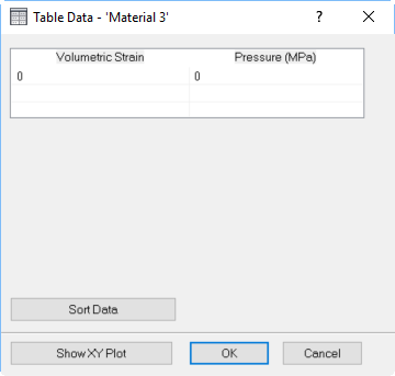

- The pressure versus volumetric strain behavior can be defined using a piecewise linear curve, where volumetric plasticity and volumetric bulking can be specified in the compression regime.
- The Volumetric strain and Pressure data in the table define the piecewise linear behavior of the pressures versus volumetric strain in compression. At least 2 points must be provided, in which case a linear response in compression is defined. The first point (EV0,PV0) must be defined at zero strain and pressure.
