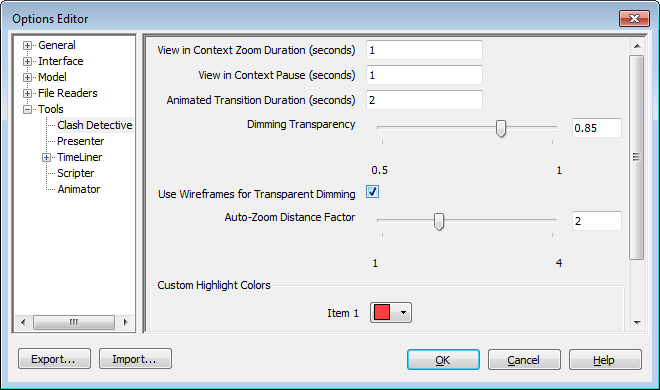

Click the application button
> Options.
Expand the Tools node in the Options Editor, and click the Clash Detective option.
On the Clash Detective page, use the View in Context Zoom Duration box to enter the required value. When you use the View in Context functionality on the Results tab of the Clash Detective window, this value specifies how long it takes for the view to zoom out (using an animated transition).
Use the View in Context Pause box to enter the required value. When performing a View in Context, the view remains zoomed out as long as you hold the button. If you quickly click rather than press and hold the button, this value specifies how long the view stays zoomed out so that the transition is not cut in mid-flow.
Use the Animated Transition Duration box to enter the required value. When you click on a clash in the results grid of the Clash Detective window, this value is used to smooth transitions from the current view to the next.
Use the Dimming Transparency slider to specify the level of transparency of items not involved in clashes.
Select the Use Wireframes for Transparent Dimming check box to display items not involved in clashes as wireframes.
Use the Auto-Zoom Distance Factor slider to specify the level of zoom applied to a clash in the Scene View when it is selected in the Results tab. The default setting is 2; 1 is the maximum level of zoom and 4 is the minimum level of zoom.
Use the Custom Highlight Colors options to specify the display color for clashing items.
Click OK.
