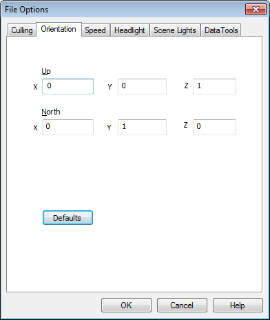

Change the World Orientation
  1. Click Home tab > Project panel > File Options .
  2. In the File Options dialog box > Orientation tab, enter the required values to adjust the model orientation.
  3. Click OK.
