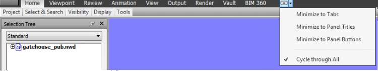

Resize the Ribbon
There are two buttons to the right of the ribbon tabs that allow you to choose the function of the ribbon toggle button and control the ribbon size.
Click the drop-down arrow
in the ribbon tab bar.
Select one of four minimize ribbon states:
- Minimize to Tabs: Minimizes the ribbon so that only tab titles are displayed.
- Minimize to Panel Titles: Minimizes the ribbon so that only tab and panel titles are displayed.
- Minimize to Panel Buttons: Minimizes the ribbon so that only tab titles and panel buttons are displayed.
- Cycle Through All: Cycles through all four ribbon states in the order, full ribbon, minimize to panel buttons, minimize to panel titles, minimize to tabs.
Click the first button to the right of the ribbon tab
to control the ribbon size. The action of this button is based on what you selected in step 2.
When the button appears in this form
, click it again to maximize the ribbon.
Tip: You can also change the ribbon size by double-clicking the name of the active ribbon tab or anywhere in the ribbon tab bar.
