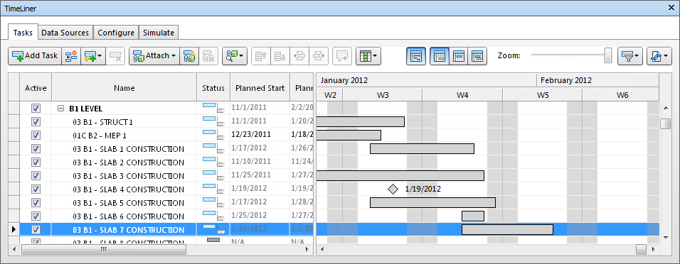

The Tasks tab enables you to create and manage project tasks. It shows all of the tasks in your schedule, listed in a table format. You can use the scroll bars at the right and at the bottom of the tab to move through the task records.
The tasks are shown in a multi-column table, which provides some flexibility in how records are displayed. You can:
Autodesk Navisworks TimeLiner supports a hierarchical task structure, as imported from a data source, for example Microsoft Projectâ„¢ (see the Data Sources Tab for more information). The hierarchy can be expanded or contracted by clicking on the plus or minus sign, respectively, to the left of the task.
Each task has its own status identified by an icon. Two separate bars are drawn for each task, showing planned against actual relationships. The color is used to differentiate the early (blue), on-time (green), late (red), and planned (gray) portions of the task. Dots mark the planned start and end dates.
Placing the mouse pointer over a Status icon shows a tooltip explaining the task status.

The check box in the Active column enables you to turn a task on/off. If a task is turned off, then it will not appear in the simulation. For hierarchical tasks, turning off the parent task will automatically turn off all child tasks.
Right-clicking within the tasks area on the tab, opens a context menu that enables you to work with tasks in your schedule.
You can use multi-selection (i.e. holding down SHIFT or CTRL) to perform most commands on several tasks at once. For example, should you need to delete all tasks, select the first task, then hold down SHIFT and select the last task, then press Delete.
The Add Task button adds a new task as the bottom of the tasks list.
The Insert Task button inserts a new task above the one currently selected in the Task view.

The Gantt Chart displays a colored bar chart illustrating your project status. Each task takes up one row. The horizontal axis represents the time span of the project, broken down into increments (such as days, weeks, months, and years) and the vertical axis represents the project tasks. Tasks can run sequentially, in parallel, or overlapping.
You can drag a task to different dates, or click and drag on either end of the task to extend or shorten its duration. Any changes are automatically updated in the Task view.
