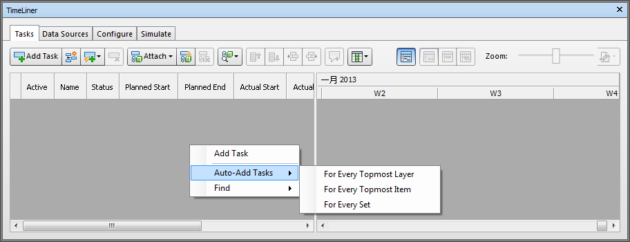

Create some tasks, each having a name, start and end date, and a task type. You can add tasks manually. Alternatively, click Auto-Add Tasks
on the Tasks tab, or right-click within the Tasks area, and create an initial set of tasks based on layer, item, or selection set names. TimeLiner defines some default task types for you (Construct, Demolish and Temporary), or you can define your own task types on the Configure Tab. You can also view a read-only graphical representation of your project schedule, and can switch between Planned, Actual, and Planned vs Actual Gantt charts.

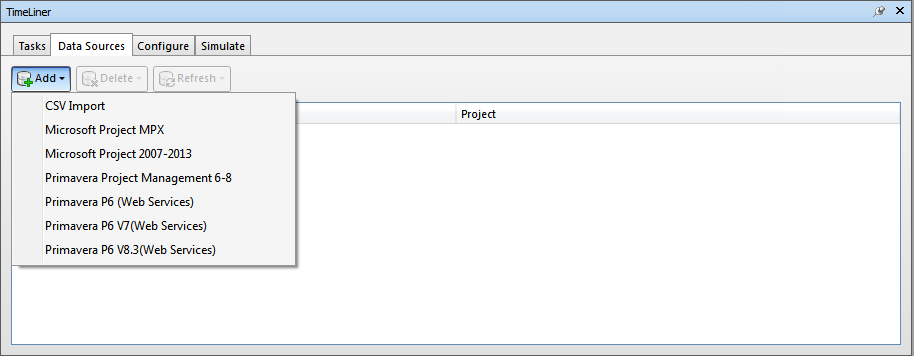

You can use the Data Sources Tab to import tasks from an external source, such as Microsoft Projectâ„¢. You can choose a field from the external schedule to define the types of the imported tasks, or you can set task types by hand. You can edit task parameters directly in TimeLiner. You can also update the schedule externally and refresh the tasks in TimeLiner to align them with those from the external source. Any changes you make to tasks imported from external project files will be overwritten next time you refresh the corresponding data sources.

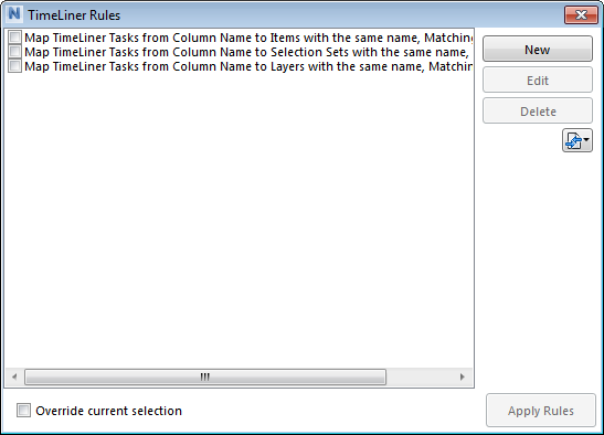

Alternatively, you can click Auto-Attach Using Rules
and Use Rules to Attach Tasks automatically.

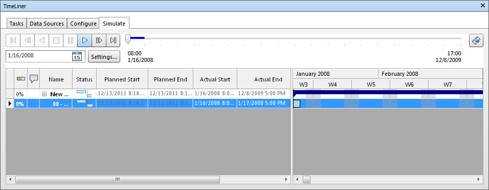

Simulate your schedule. You can visualize your model at any date in your schedule with the currently active tasks highlighted. Run through the entire schedule using the controls. You can Add Animation to TimeLiner Schedules to your construction schedules, and enhance the quality of simulations.

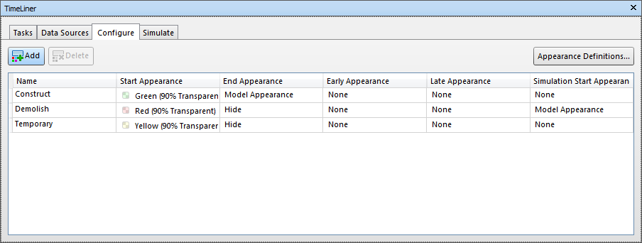

Adjust the way your simulation plays. You can use the Configure tab to create new task types and edit old ones. The task type defines what happens at the start and end of each task of that type. You can hide attached objects, change their appearance or reset them to the appearance specified in the model.

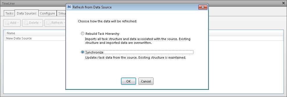

Keep up to date with changes in your project. Save your project as a Navisworks NWF file. Open the NWF and Synchronize Tasks with Project Changes.
