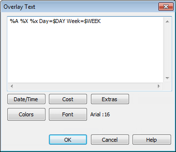

You have the option to define the text overlaid in the Scene View during simulation, by clicking Edit in the Simulation Settings Dialog Box.
By default the date and time are displayed using the format specified in Control Panel > Regional Settings. You can specify the exact format to use by entering text into the text box. Most text will appear as entered, except that words prefixed with a “%” or “$” character act as keywords and are replaced with various values. The Date/Time, Cost, and Extras buttons can be used to select and insert all possible keywords. The Colors button can be used to define the color of the overlay text.
The Font button brings up the standard Microsoft Windows font picker dialog box. Once the correct font, font style and point size have been selected, press OK to return to the Overlay Text dialog box. The current font selection is shown next to the Font button, and during the TimeLiner simulation, all text on the overlay will be shown using this font.

Type CTRL + Enter to insert a new line into the overlay display text.
