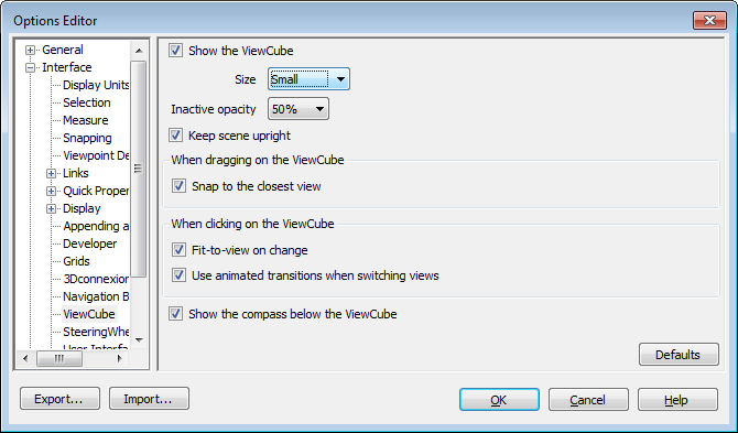

To Use Animated Transitions when Reorienting a View to a Preset Orientation
  1. Right-click the ViewCube tool, and click ViewCube Options.
  2. In the Options Editor > Interface node > ViewCube page, select Use Animated Transitions When Switching Views.
    When checked, transitions from one view to another appear animated when clicking a predefined area on the ViewCube tool.
  3. Click OK.
