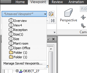

Recall a Viewpoint from the Ribbon
  1. Click Viewpoint tab > Save, Load & Playback panel > Current Viewpoint drop-down, and choose the saved viewpoint from the list.
    The viewpoint is now displayed in the Scene View.
