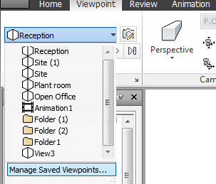

Organize Viewpoints into Folders
  1. Click Viewpoint tab > Save, Load & Playback panel > Current Viewpoint drop-down > Manage Saved Viewpoints.
    This opens the Saved Viewpoints window, and makes it the active window.
  2. Right-click an empty space in the Saved Viewpoints window, and click New Folder.
  3. Type in a new name, and press Enter.
    Tip: Use names that can help you identify your viewpoints in future.
  4. Drag the required viewpoints into your new folder.
